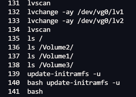

Solution - Step by Step:
Step 1: Manually Assemble RAID Arrays
Instead of using --scan, assemble each array manually with its correct UUID:
# Assemble main volume (7.3TB)
mdadm --assemble /dev/md0 --uuid=a33e66aa-6544-a767-8ee5-b7f56939d541 /dev/sda4 /dev/sdb4
# Assemble secondary volume (5.5TB)
mdadm --assemble /dev/md2 --uuid=4a5b9ffc-b954-9344-009e-8b75389cbc45 /dev/sdc4 /dev/sdd4
# Assemble swap (optional but recommended)
mdadm --assemble /dev/md3 --uuid=f5b4c951-b9e5-088d-723a-2e6d993e4d5b /dev/sda3 /dev/sdb3
# cat /proc/mdstat
md3 : active raid1 sda3[0] sdb3[1]
md2 : active raid1 sdc4[0] sdd4[1]
5848949636 blocks super 1.2 [2/2] [UU]
md0 : active raid1 sda4[0] sdb4[1]
7802074636 blocks super 1.2 [2/2] [UU]
# Scan for volume groups
vgscan
# Activate the volume group
vgchange -ay vg0
# Verify volumes are active
lvscan
# Should show: ACTIVE '/dev/vg0/lv1' and '/dev/vg1/lv2'
# Generate correct configuration
mdadm --detail --scan > /etc/mdadm/mdadm.conf
# Verify the file

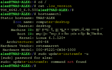

cat /etc/mdadm/mdadm.conf
This updates the boot configuration so arrays assemble automatically on next boot:
update-initramfs -u
# Mount the volumes
mount /dev/vg0/lv1 /Volume2
mount /dev/vg1/lv2 /Volume3
# Verify
df -h | grep Volume
# /dev/mapper/vg0-lv1 7.3T 3.9T 3.5T 53% /Volume2
# /dev/mapper/vg1-lv2 5.5T 2.0T 3.6T 36% /Volume3
