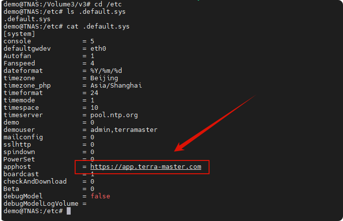

After analysis, we have initially determined that your NAS may not be receiving the normal application update push. Please access the NAS backend via the terminal (which can be found in the "All Applications" section of the desktop navigation bar) and run the following command to check if the configuration file is complete, paying particular attention to the part marked with a red arrow in the image. If you are unfamiliar with the process, please visit our official website and contact Live Chat, where we can arrange for an engineer to provide remote support. Thank you for your understanding, and we apologize for any inconvenience caused.
cd /etc
ls .default.sys
cat .default.sys

As I have told your team, many, many, many times.
"My NAS" isn't having this problem. MANY Nas's are. Here is my file... not so I can resolve this issue, I no longer expect this from Terramaster. But so I have helped as much as I can YOU TO FIX THE ISSSUE FOR ALL CUSTOMERS.
Read through my past ticket history to see how these files are 'not as they should be' and no... i haven't changed them. These are how they are and are in production. Any fixes to these problems must come via firmware updates and not manual tweaks. If you want to fix this problem, then do your job and FIX YOUR SOFTWARE WITH AN UPDATE.
And no, I'm not interested in yet again "contact terramaster customer support" so you can fix these types of problems as one-off fixes and STILL REFUSE TO FIX THE INBUILT ISSUES IN YOUR FIRMWARE.
:/etc# cat .default.sys
[system]
defaultgwdev      = eth0
checkAndDownload  = 1
disk_write_cache  = 1
bb_notify_enabled = 1
smart_test_report = 0
Fanspeed          = 4
Autofan           = 1
PowerSet          = 1
I'm so sick of this. I'm sick of waiting for you to add the features requested or fix bugs with firmware updates. At this point, I'm done with Terramaster. If you expect to exist in 2025 with software like this that doesn't add any new features or fix any bugs in non-major updates, runs application packages like Virtualisation software 5+ years too old with "we worry about stability" as an excuse... I have nothing more than I can bring to your attention in terms of what your customers need from you. We are all worried about stability but if you can't update an application package or keep your NAS devices application store working over two years then what are we doing here?
