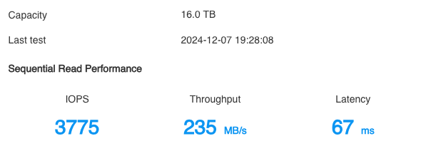

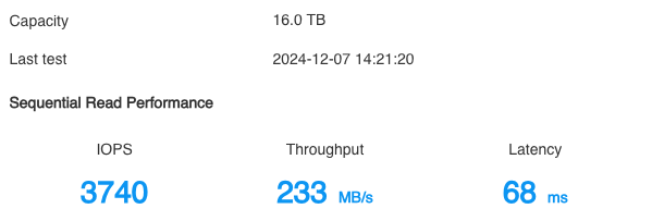

I used the TOS benchmark test and these are the results for each 16tb drive. I do not know how to adjust the cache mode, I assume the drive is utilizing 256mb. When I setup the NAS, I used the default setup.
HARD DRIVE 1
HARD DRIVE 2
Imageimage free upload

From the benchmark test results, your drives seem working fine. Please check the network connection issue and confirm whether your network bandwidth meets the video bitrate you want to play.
