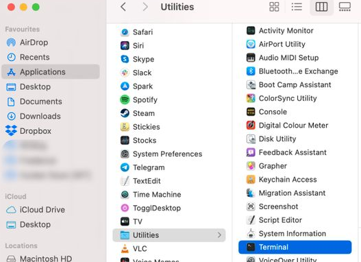

Mac
1.Please open "Finder-Applications-Utilities" or "Launchpad", find "Terminal" and launch it.
