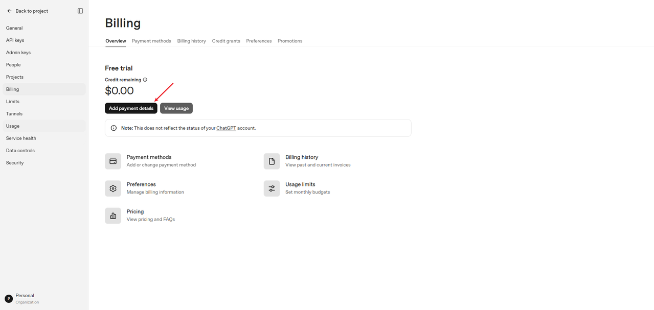

2.After creating it, you will receive the [ API key ] ( You can purchase the plan through the official link: https://platform.openai.com/settings/or ... g/overview).

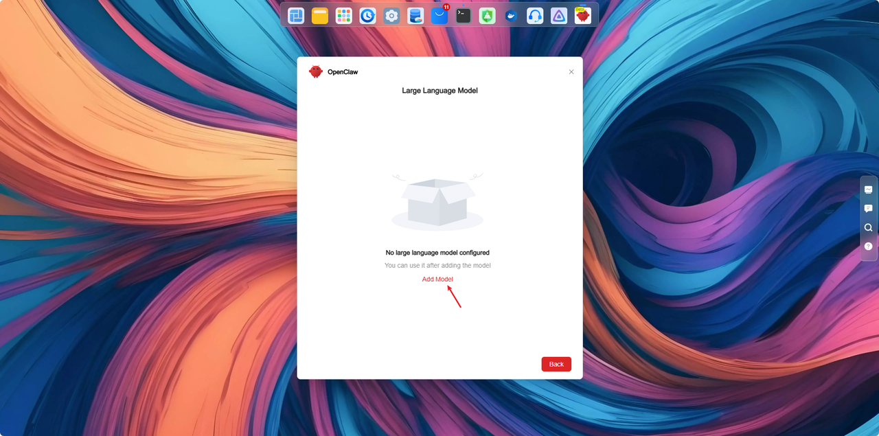

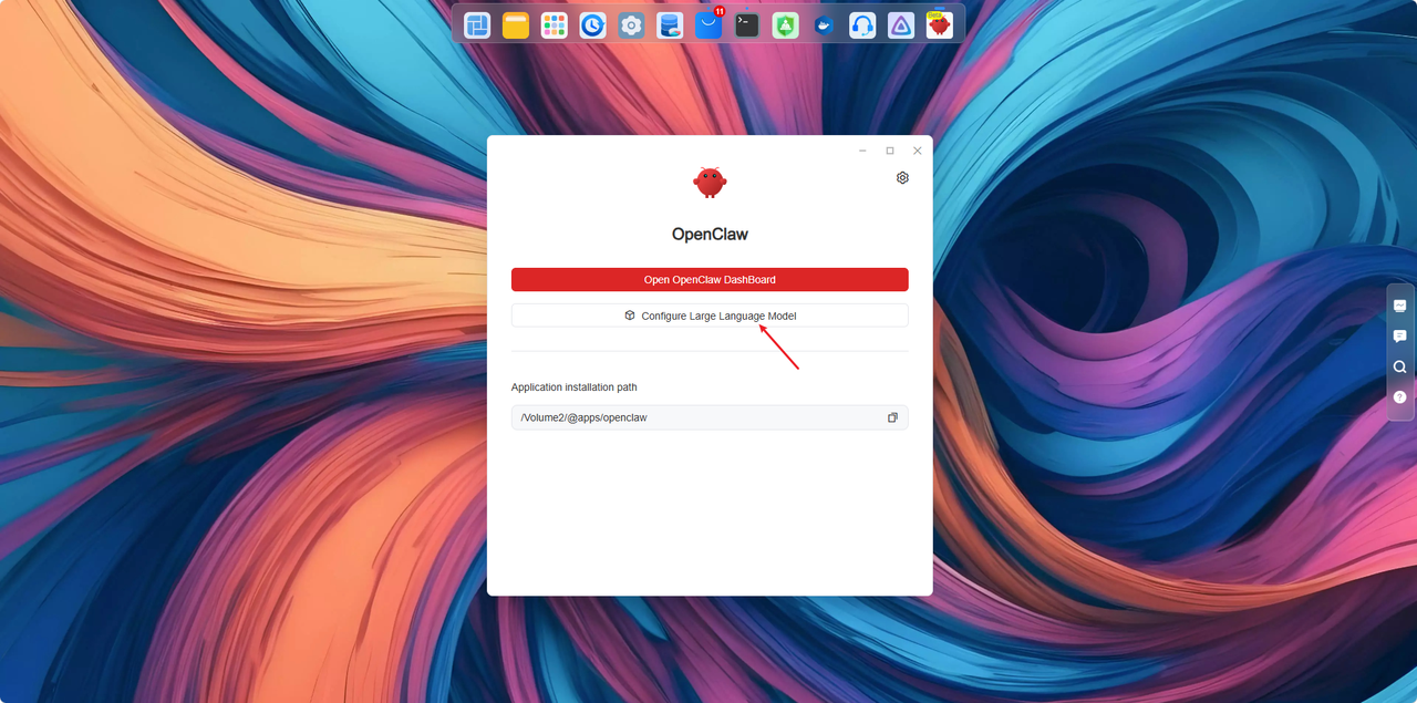

1.Open the model configuration page
On the TNAS device, use the super administrator account to open the [ OpenClaw ] app, and directly click [ Configure Large Language Model ] to enter the model configuration page.

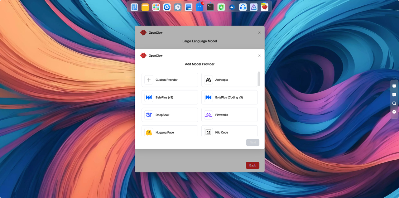

2. Select a model service provider
Choose the corresponding model provider from the service provider list.
For example:
● OpenAI
● Anthropic
● Gemini
If your desired service provider is not listed, or if you need to access the model service through a proxy server, please select [ Custom Provider ].

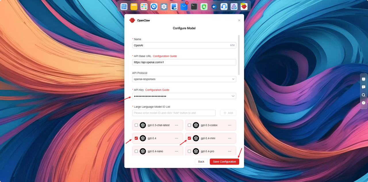

3. Fill in the model information
Using OpenAI as an example:
● API Key: Enter the API Key you just created
● Model: Select the model you wish to use (e.g., gpt-5.4)
After filling in the information, click [ Save Configuration ].
Once the system prompts that the save is successful, you are ready to start using it.

3. If the error message appears as shown, it means there are insufficient tokens in your plan. Please visit the OpenAI official website [https://platform.openai.com/settings/or ... g/overview] to purchase more tokens.
