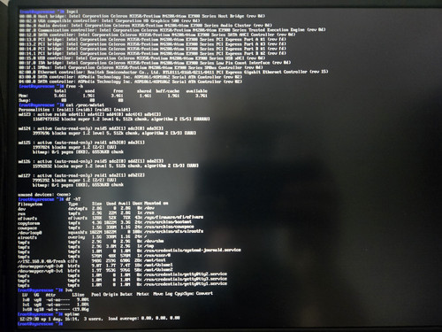

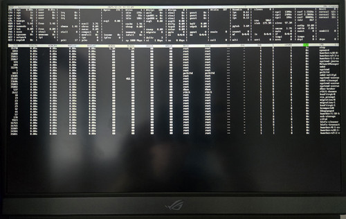

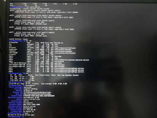

New Install - after Factory Default (and configuration backup)
eth0 mac: 6cbf.b501.5f4c assigned initial ip 192.168.0.163 (dhcp 016c.bfb5.015f.4c)
eth1 - disconnected
Note: No one of the specified in the post (viewtopic.php?t=6433) initboot images is accepted!
The recommended "Online download" way used - the console log shows: initBoot (567)
Same method was used for the Bootloader. That one was staying on 99% ready for more than 10 minutes. On the console we have that
Specified local (md5 verified) TOS image:
The TOS installation was waiting longer on 60% (maybe the existing arrays were resyncing) then jumped on 92%, 100%
finally reload...
EULA confirmed, user created, security email - code passed
Security Advisor initiated: HTTP(S) ports, SPC, Isolation and Snapshot at risk
- for HTTP(S) ports changed to 7171 / 7443
Waiting to validate stability
5 minutes later - it shutdown himself with no reload this time.
Any suggestions for next step?

Already verified that in a simple way - System Rescue live USB running more that 24 hours and the NAS is in the same conditions:
- same UPS (for any power variations ^ outlet problems)
- same ethernet bond (for any load-balancing related problems)
- same switch on the same ports (for any static electricity problems)
- same KVM
I enabled samba on the System Rescue (Arch linux actually), mounted the existing LVs and shared them on the local network.
Everything is working stable and fast.
Few photos to give you more details:
Any other suggestions?
