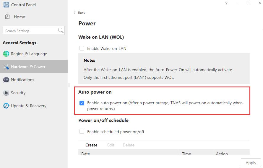

I have an x86 2 drive model. Is there a way to configure it so after a power failure it will automatically turn on? If this was a pc I would go into bios and make sure that setting was set, but not sure how to do that here.
Re: How to restart after power failures, without having to press power switch
Please set it at TOS Control panel- General settings- Hardware&Power:

That was embarrassing, I must have been clicking too fast and missed it. Thanks.

Be sure that your power failures aren't the "cluster" kind we have around here. When our power blinks it usually comes on and off several times in the course of a few seconds. Without a UPS to smooth over these hiccups I would avoid the power-back-on-automatically-setting since the surges can fry electronics and disk drives.
