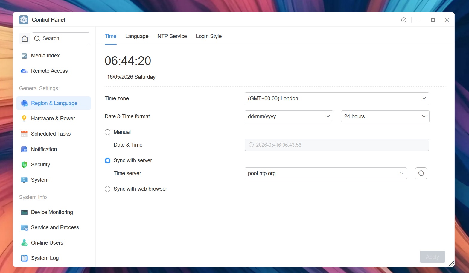

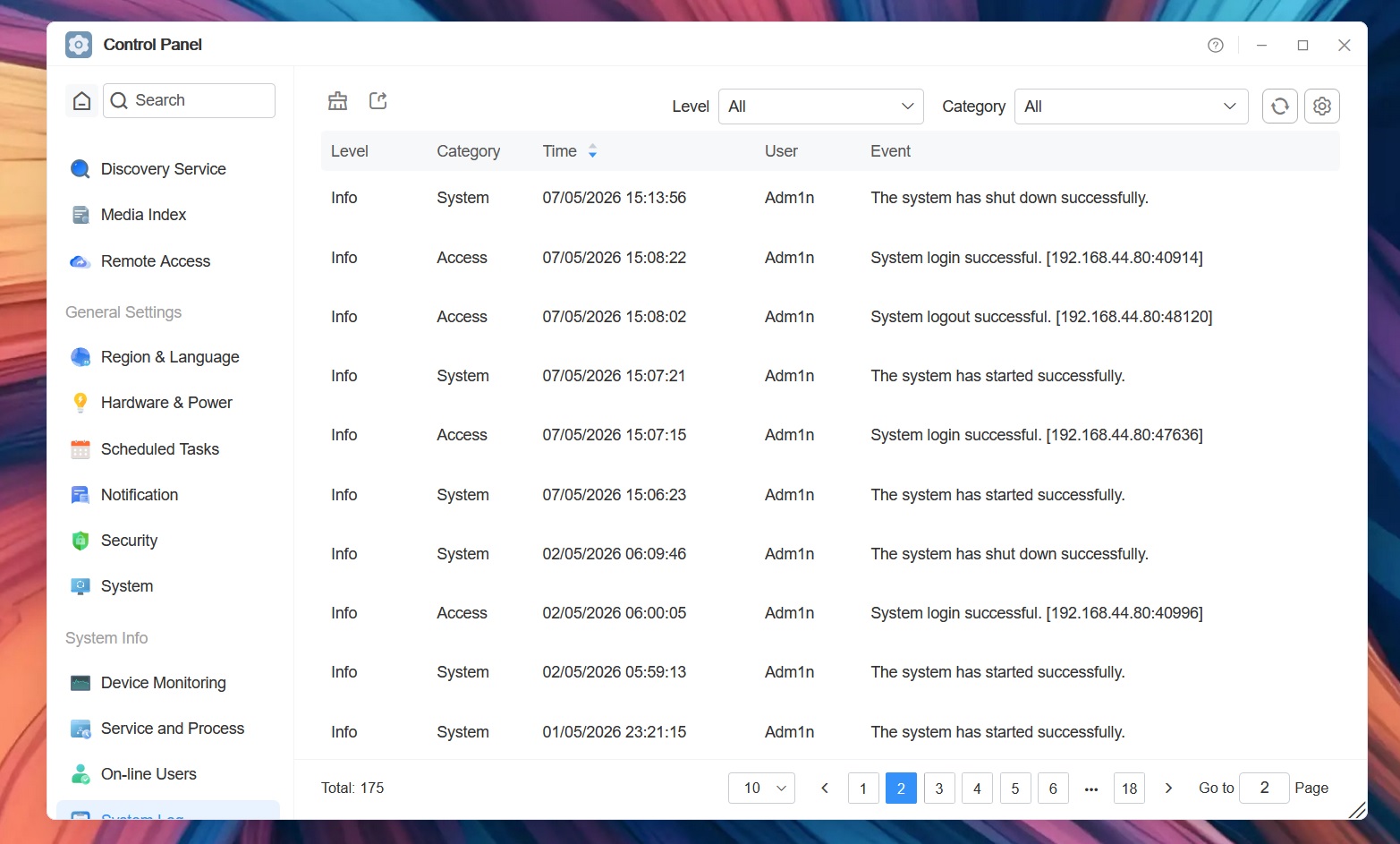

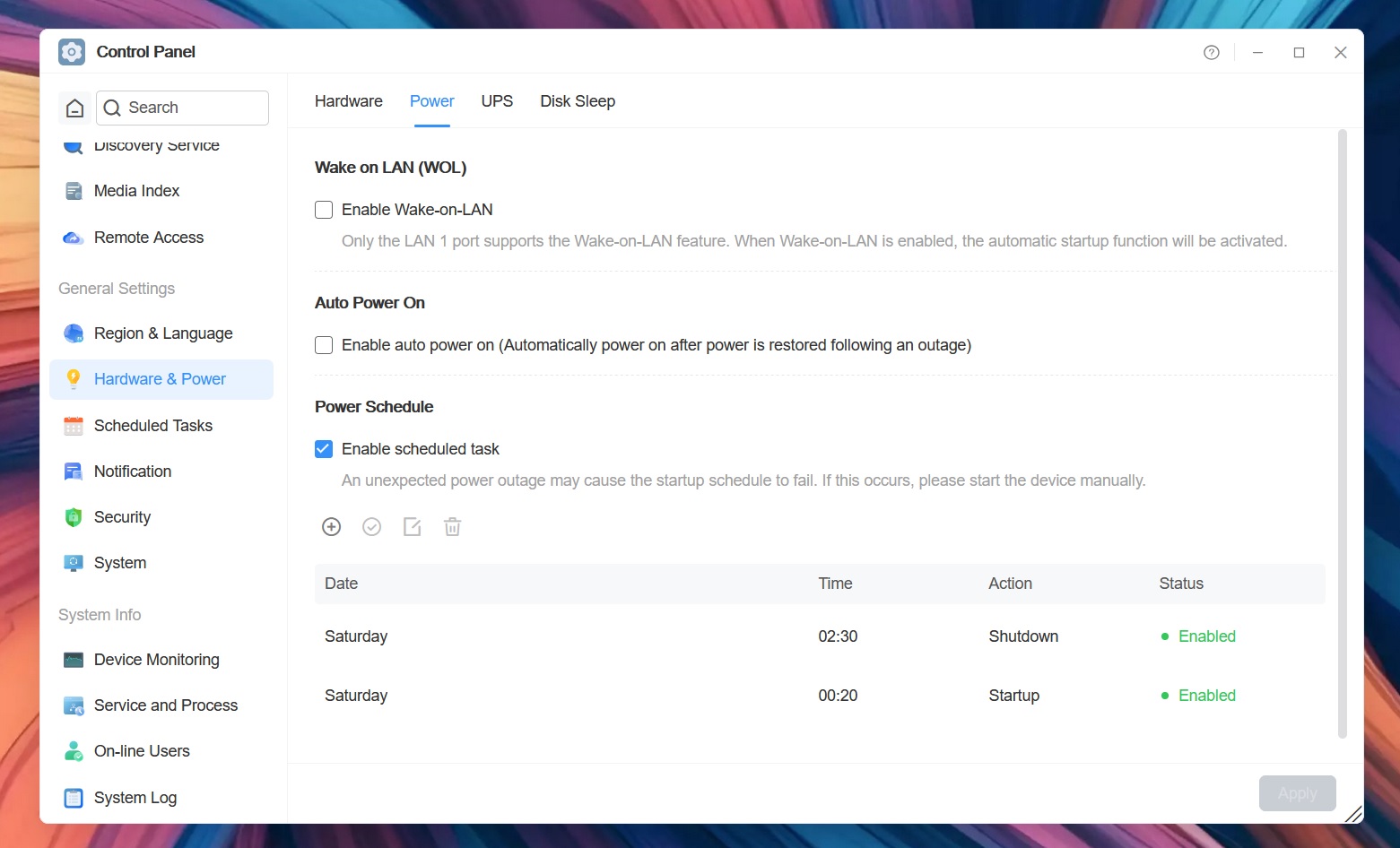

System log seems to ignore 'summer time'.
My time zone is GMT so currently we are effectively on GMT+1. The settings should be shown in the first image.
The NAS is set to turn on at 00:20 and turn off at 02:30 as shown in the second image.
The bottom entry in the log in the third image shows the NAS as turning on at 23:20 on the previous day. (There's also no log entry for the scheduled shut-down.)
Is this correct?

Regarding the time zone issue, I will report it to the product team for further verification.
