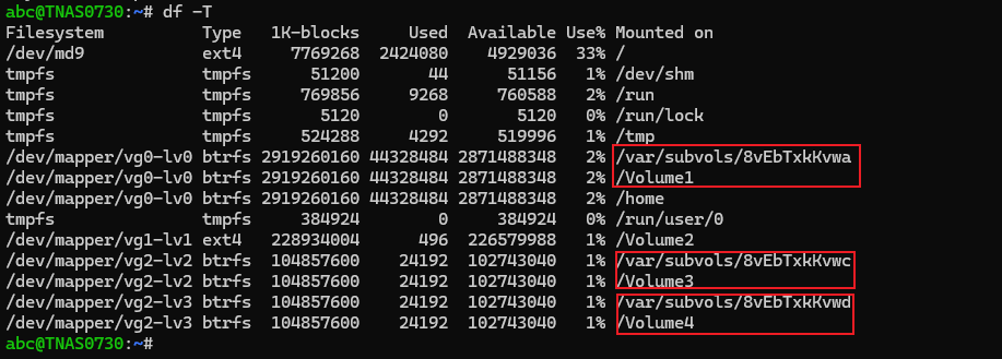

TOS6.x
cd /
umount /Volume1
umount /var/subvols/8vEbTxkKvwa
umount /home
Whether you are using the ext4 or btrfs file system, if the volume to be unmounted is not the first volume in the file system, you must modify the default command "umount /Volume1" by replacing "/Volume1" with the corresponding volume name. For example, to unmount the second volume, the command should be "umount /Volume2".
Additionally, in the btrfs file system, when executing commands such as "umount /var/subvols/8vEbTxkKvwa" for subvolumes corresponding to non-first volumes, the command must also be adjusted. For instance, change it to "umount /var/subvols/8vEbTxkKvw?", where the "?" should be replaced with the corresponding subvolume name. All such names can be confirmed using the "df -T" command. As shown in the figure below:
