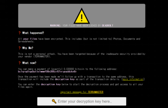

Method 1:
Enter the TNAS IP in the browser address bar. If the following page appears on the login interface, it means that your TNAS has been attacked by the Deadbolt ransomware.

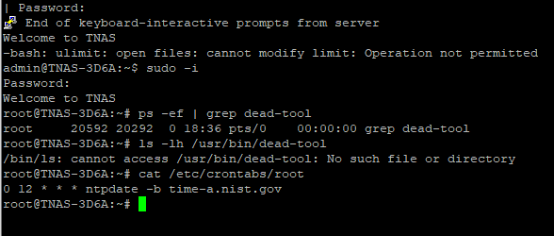

Method 2:
1. Log in to the SSH terminal
2. Execute the command to check if there are files with the word "Dead".
ls -lh /usr/bin/dead-tool
3. Execute the command to check if there are files with the word "dead-tool、pty10、qnx".
cat /etc/crontabs/root
After executing the command, if you see a file with the words "Dead, dead-tool, pty10, qnx", it indicate that your TNAS has been attacked by Deadbolt ransomware. Please refer to the guide to remove the virus.

Apologies, but your second screenshot can cause confusion.
It shows a system that is NOT infected, yet the following statement suggests it would indicate that it is infected.

Sorry to confuse you, the second image just demonstrates the execution steps of the command.

It did not confuse me, but it may confuse others :)
Thank you for posting this, though.
It is good to be able to confirm that my system is Deadbolt free.
