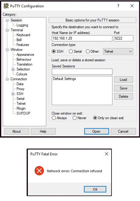

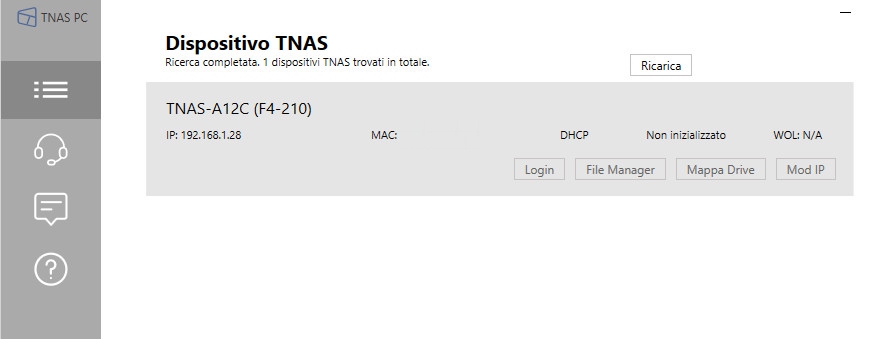

The screen has been "LOADING" for four days .... and I think there is something wrong with the filesystem at this point. :? :?
I tried to follow the guide as in the topic "viewtopic.php?f=75&t=2350" and "viewtopic.php?f=79&t=2575 " but Putty refuses to go.
What can I do?
I enclose some screens ....
TerraMaster Team
Posts: 1223
Re: "Loading" screen
{L_BUTTON_AT}sound
Since the solution is a bit cumbersome, please contact the technical support mailbox and make an appointment with an engineer to assist with remote processing.
